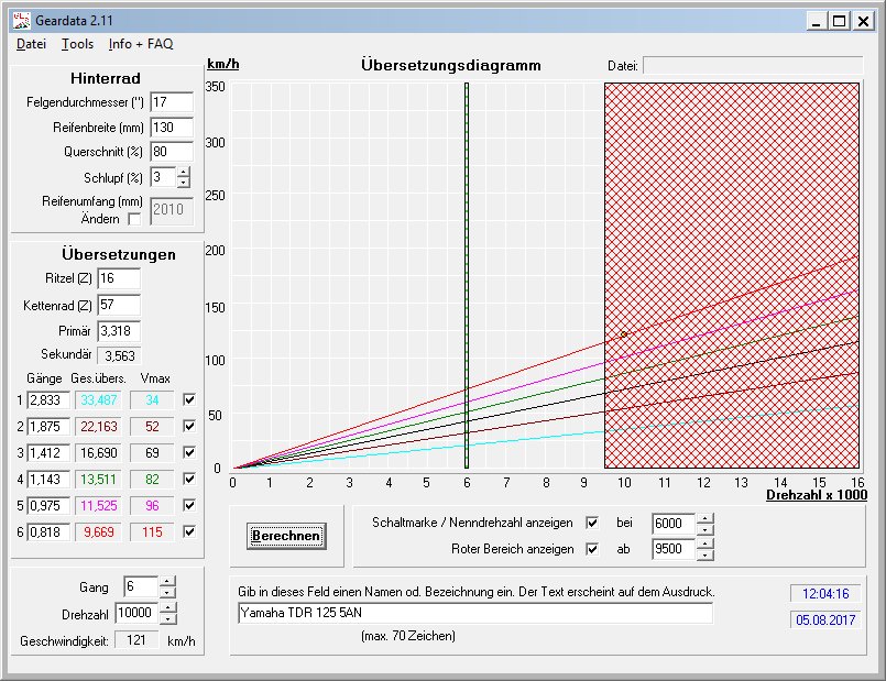

This is screenshot of Geardata.exe, again: 115 km/h real speed at 9500 real rpm are correct! 125 km/h at 9500 rpm is wrong, so perhaps there is a measurement fault at the GPS device...

Look at the Screenshot of GEARDATA ...
the RED ZONE is set to 9500 rpm, 6th gear displays 115 km/h "max speed"
below that --> calculation area shows 6th gear --> 10.000 rpm at 121 km/h
with standard sprockets 16 / 57 these are the calculated values !!! ;)
You can - if your engine is in excellent condition - change sprockets perhaps to 17 / 57, then your bike will go faster: 122 km/h at 9.500 rpm.
GEARDATA considers also the slip, about 3% !!!
I don't know what this "chinese thing" calculates: My many tests using bike GPS (2 x of type GARMIN) confirmed the correct calculation of GEARDATA...
