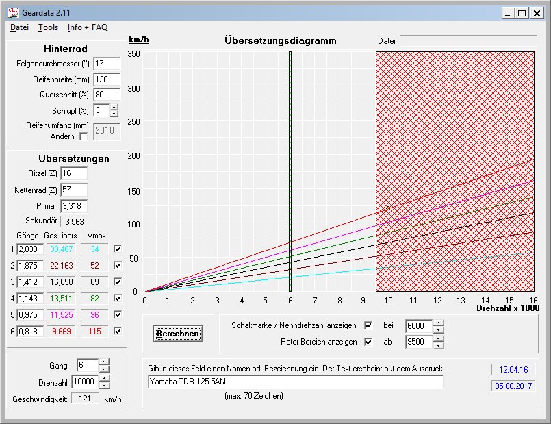

This is screenshot of Geardata.exe, again: 115 km/h real speed at 9500 real rpm are correct! 125 km/h at 9500 rpm is wrong, so perhaps there is a measurement fault at the GPS device...

Returning to Vmax subject.You prooved your opinion with arguments.But I measured again speed with same GPS device [Xiaomi Redmi note 2], and showing the same result.I think GPS should work correctly , always repeatable.Navi on screen represent exactly what is on area ,very close.Do You think it's possible ?Mayby tacho is broken?The exhaust is original but derestricted completly.
Physics and Mathematics can not be deceived.
Look at the Screenshot of GEARDATA ...
the RED ZONE is set to 9500 rpm, 6th gear displays 115 km/h "max speed"
below that --> calculation area shows 6th gear --> 10.000 rpm at 121 km/h
with standard sprockets 16 / 57 these are the calculated values !!! ;)
You can - if your engine is in excellent condition - change sprockets perhaps to 17 / 57, then your bike will go faster: 122 km/h at 9.500 rpm.
GEARDATA considers also the slip, about 3% !!!
I don't know what this "chinese thing" calculates: My many tests using bike GPS (2 x of type GARMIN) confirmed the correct calculation of GEARDATA...
