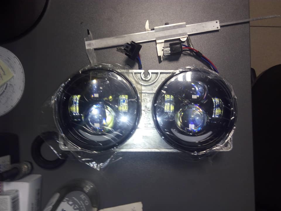

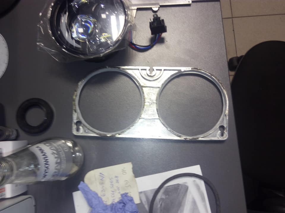

I worked out my lights before end of last season. Changed it to LEDs
Had to make some measures and grind a lot of material but it fitted very well. I glued it on car windshield glue.

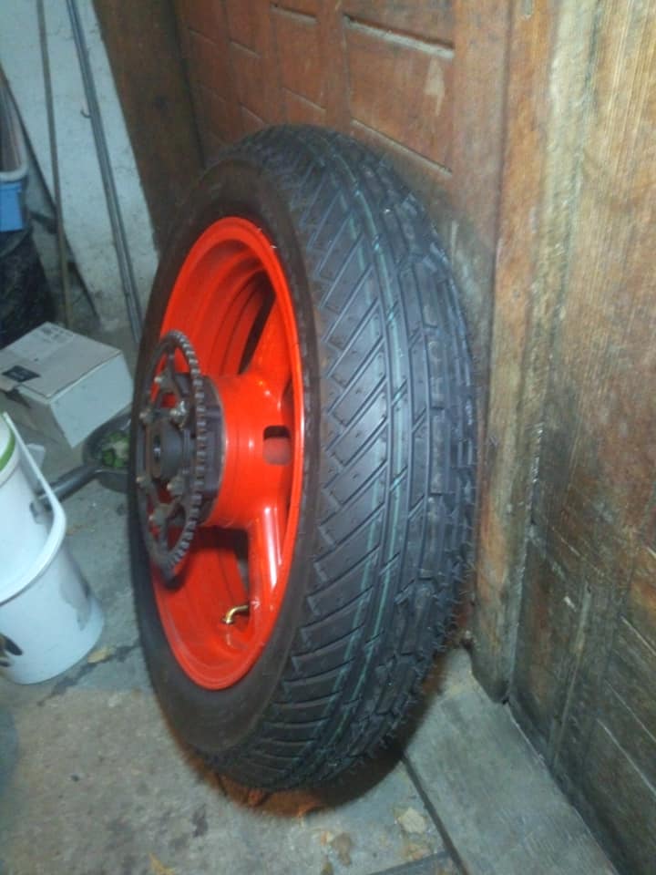

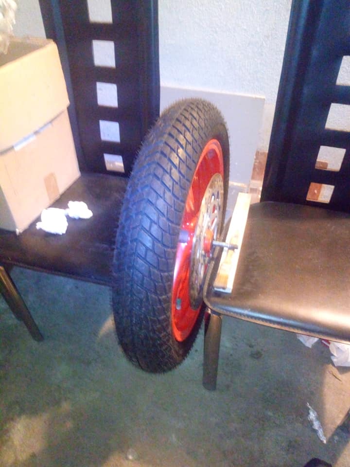

I've fitted new tyres this week, I hope it will be better in wet conditions, while balancing it showed me that I need to change rear wheel bearings.

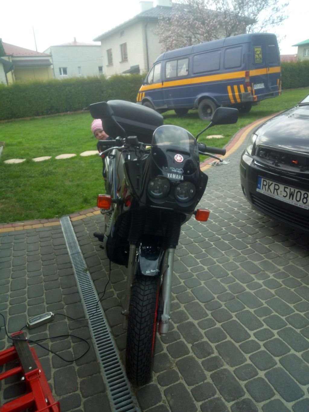

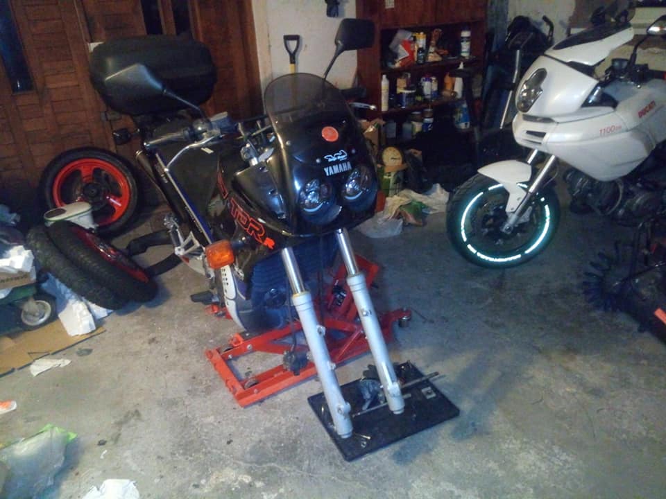

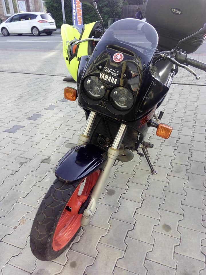

Front:

Very, very nice work, unfortunately, such a conversion to LED in Germany is not allowed, the authorities (TÜV) check that very carefully.
Thank you for your pictures and that you minimized the size of the pics very well, so you get a :thumbright: from me 8)

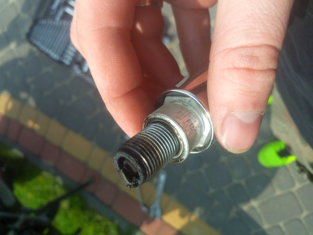

I was pissed of after first ride of this season as carb isn't set up properly and it has fuel overflowing on idle making it stall. Hard to start too.
Also front fork stated leaking oil. I changed oil seals in october last year...
Did it again 2 days ago, hope it will be ok.
Changed dust seals too and installed fork covers and new mud flap, as mine was loose(broken ears)
I had this problem every year after winter break: The floating needle valve (hope its the correct word) inside carb is stuck so fuel has free way to go into the chamber and fload it. Now I use "Profi Fuel Max" to prevent dirtyness inside the carb.
Your spark plug does not look very fine, the mass electrode (anode) looks like it had contact with the piston?
