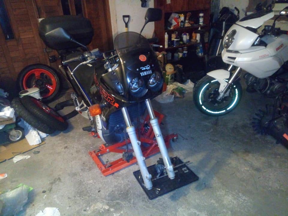

I've bought tdr125r month ago. My first bike ;)
I've already changed the sprockets, chain, front pads and fork seals(this plastic cover on brake caliper is pain in the A$$ to take off or maybe I just don't know how to do it...).

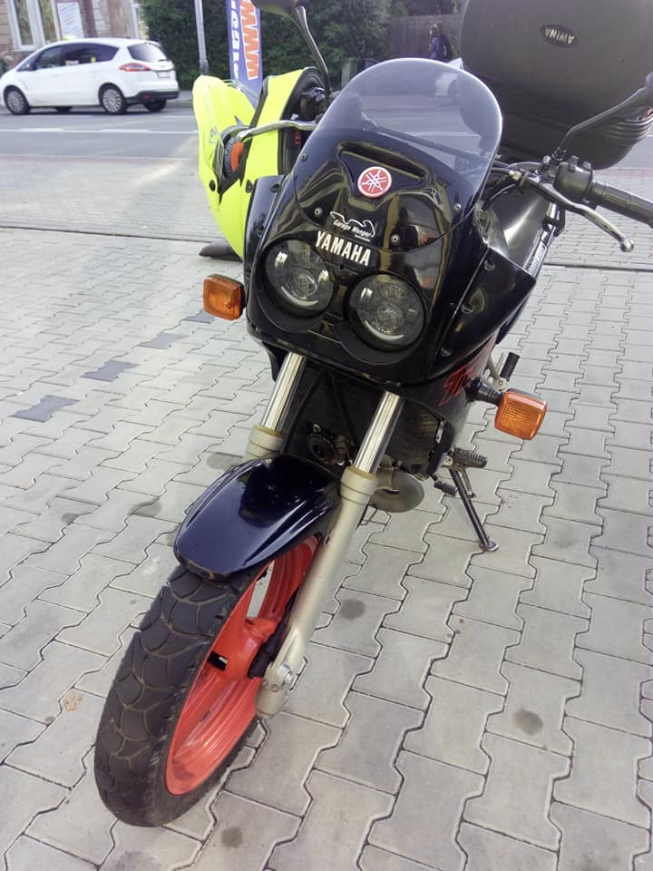

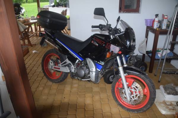

new season is comming so I have to check up my bike as I was busy in winter with making LKW licence.

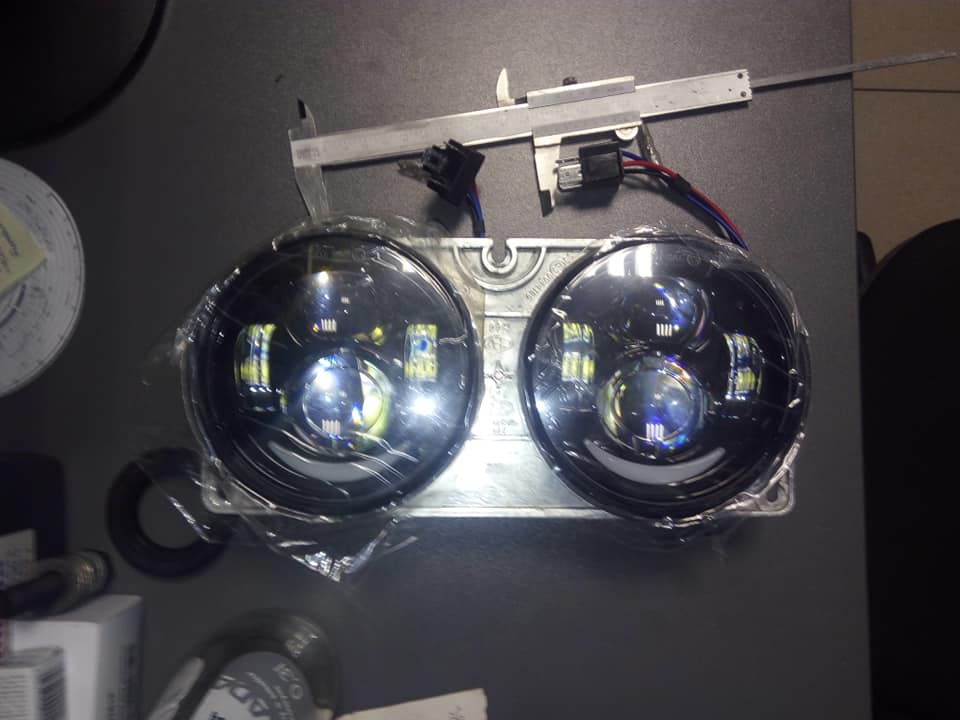

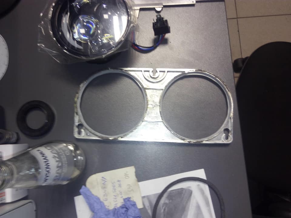

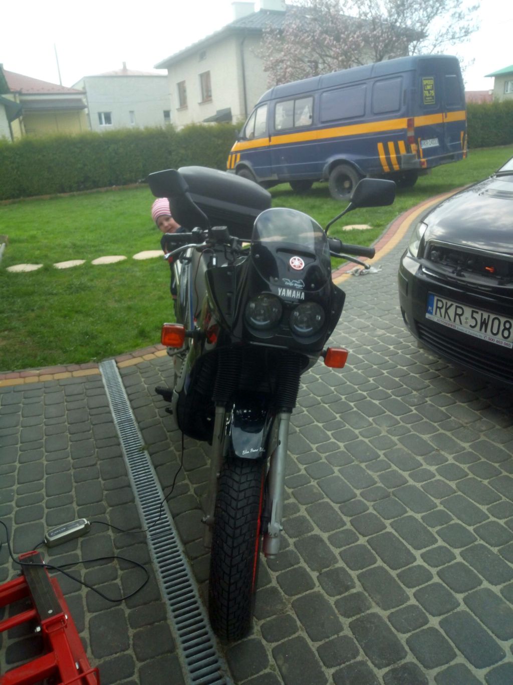

I worked out my lights before end of last season. Changed it to LEDs
Had to make some measures and grind a lot of material but it fitted very well. I glued it on car windshield glue.

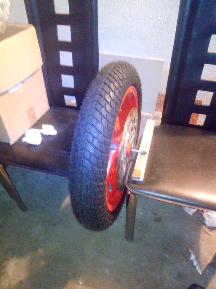

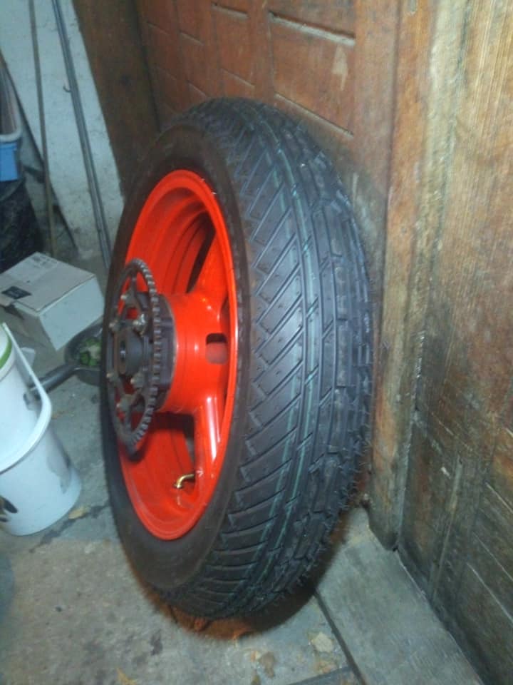

I've fitted new tyres this week, I hope it will be better in wet conditions, while balancing it showed me that I need to change rear wheel bearings.
Front:
Rear:
I'm also taking the carb apart as it wouldn't start if it was standing more than a week, and it was choking at around 5-6k rpm while riding.
I hope I'll manage to make it more fuel efficient as it was mostly doing 7l/100km.

Hello Pawel,
Very, very nice work, unfortunately, such a conversion to LED in Germany is not allowed, the authorities (TÜV) check that very carefully.
Thank you for your pictures and that you minimized the size of the pics very well, so you get a :thumbright: from me 8)

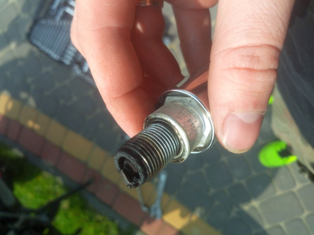

Your spark plug does not look very fine, the mass electrode (anode) looks like it had contact with the piston?
